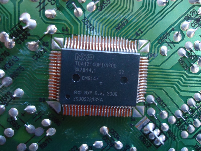

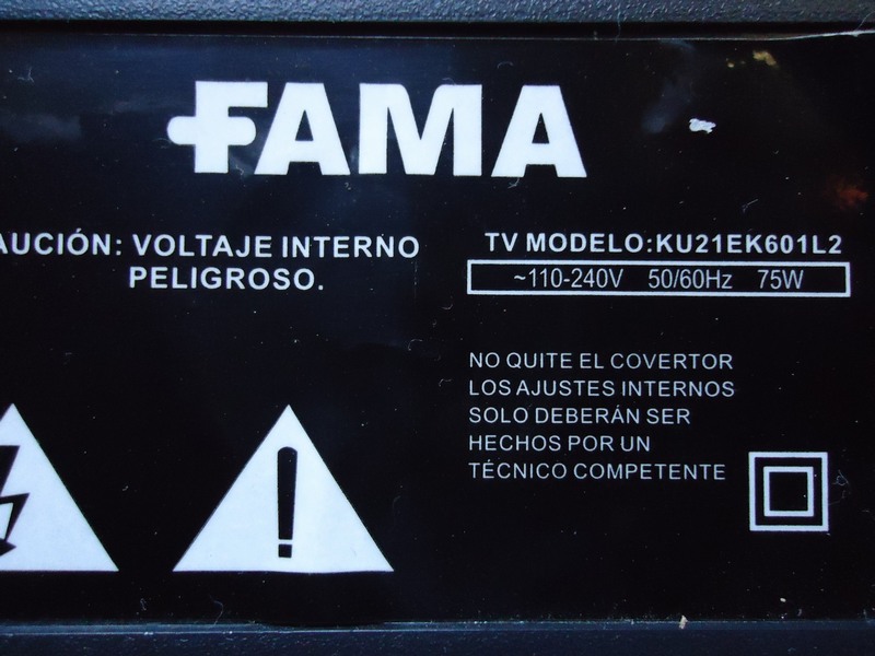

FAMA KU21EK601L2 aporte de eeprom 100 %probada
Fuente.............................STRW6753
Micro..................................TDA12140H1/200
Memoria.............................24c16wp
Audio..................................TDA2615
Vertical................................STV8172A
Horizontal.............................D2901
sintonizador.........................TDQ B FSNS2/2
Flyback..................................BSC25-N3402K
yugo........................................SCP-211B11UXD
N952(CW7805)
N953(AS7805)
V405(WFF630
FAMA KU21EK601L2.rar
data eeprom funcionando 100%
(475 Bytes) Descargado 723 veces
